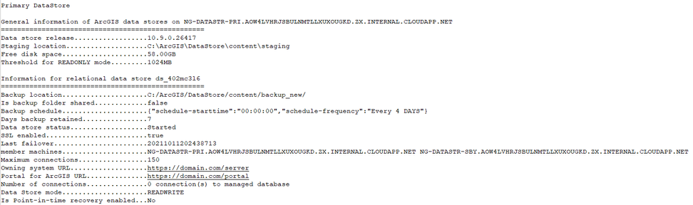

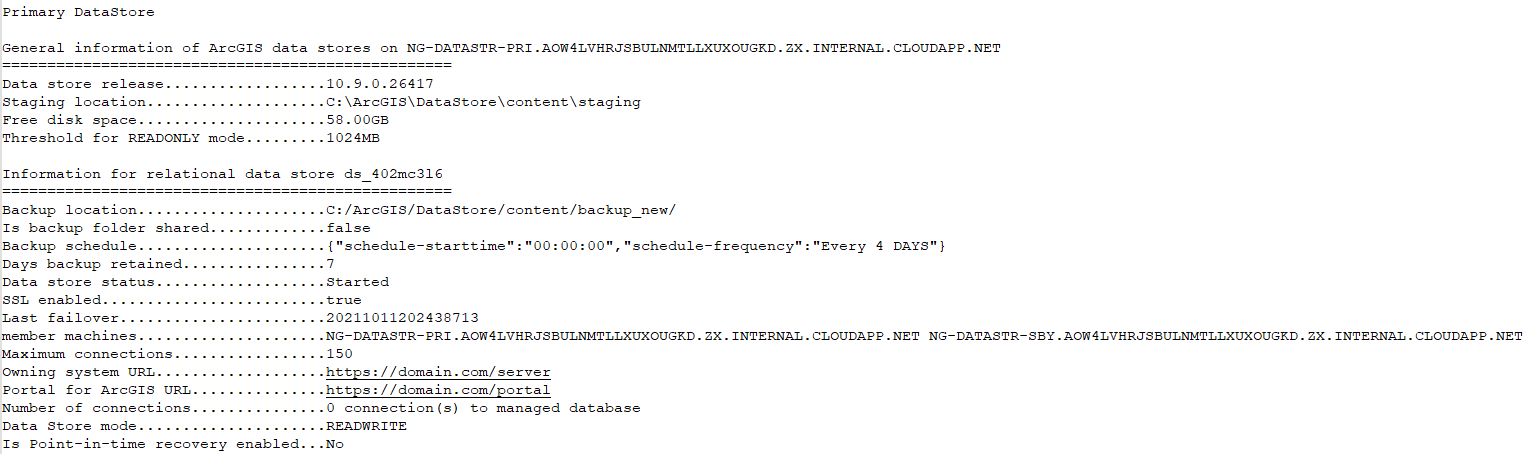

I have a datastore associated with a HA deployment (10.9) which has been switched off for a while. I am in the process of upgrading this to 11.1. As part of the regular checks, it is found that the datastores are not synchronised. Looking at the primary datastore, it is not recording any logs in the usual /content/logs/servername/server folder. describedatastore.bat shows log location is empty:

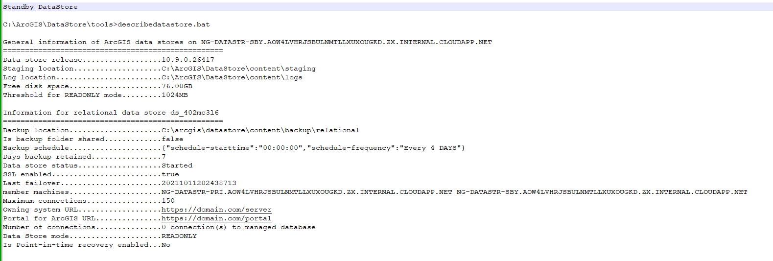

The standby datastore machine seems working properly as shown below:
However the datastore mode is: READONLY in standby.
