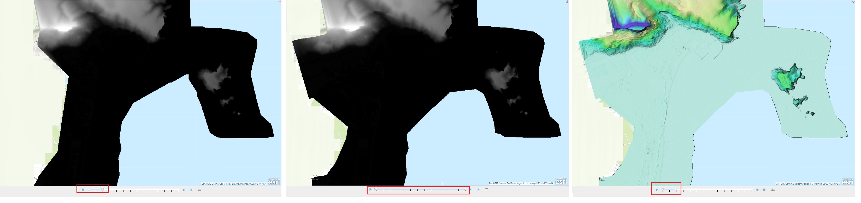

Hi all,
I have create an Imagery Service with ArcGIS Pro 2.8 with a MosaicDataset with 3 raster layers of different years. This MosaicDataset has an Time attribute, so I can choose with a TimeSlider in ArcGis Pro which raster I would like to see. Also I can do it the same with the Imagery Layer published in Portal for Enterprise 10.8.
Problem: I have also created a Custom raster function (shadedrelief.rft.xml) with ArcGIS Pro that I have shared to Portal for Enterprise. I can use this raster function in MapViewer but always is running over ALL temporal range, not only over the selected.
Question: Maybe I have to configure some parameter that I have missed in the process? (Attached image shows an example of this behaviour)
