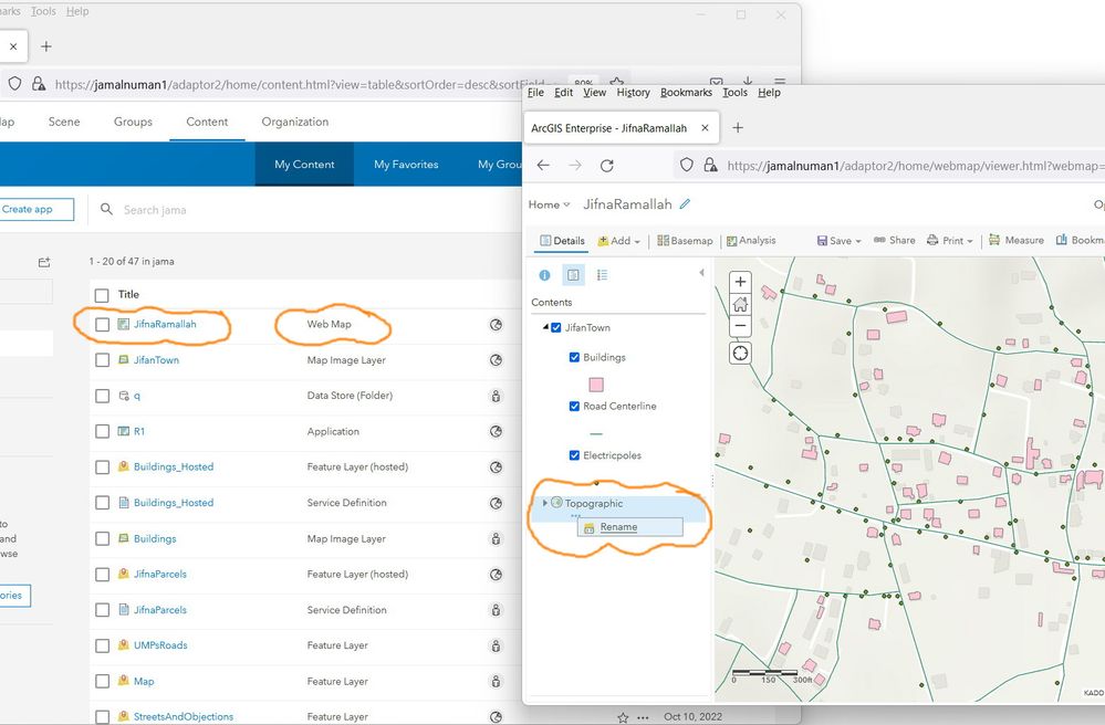

ArcGIS Enterprise 11.0: How to delete the topographic service from the web map viewer?

You can't remove the last remaining basemap layer. It sets up a lot of the Web Map, including the coordinate system.
What you can do is:
  • Change the basemap; or
  • Customise the basemap
To customize the basemap you will need to add another layer (e.g. Esri world imagery) into the basemap before you can remove the topographic layer.
https://doc.arcgis.com/en/arcgis-online/reference/choose-basemap.htm

Jamal,
        the Topographic service is your basemap. Every web map has a basemap.  You can use the Basemap tool to select another basemap that will be less distracting.  The Light Gray Canvas would be a nice choice.
Another option is to use one of your own layers as the basemap but I don't think this is possible with a hosted feature layer.  I know when I add a map service from our own ArcGIS Server I have the option to use it as the basemap:
