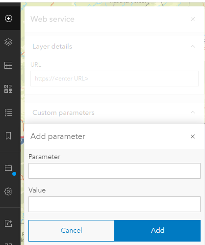

Hello All,
When setting up a Map Viewer, using the Add a Web Service tool, You can add Custom Parameters.
The only information I can find on this feature is HERE.  Starting at step 4.  There is no other reference to what type of queries that will work here.
It is quite frustrating because there is no information on how to set up the Parameter or the Value.  It is not the same as just configuring a query in a service's ArcGIS REST Services Directory page.  For example, I fell into a discovery that you need a '/' AFTER the layer number (..../rest/services/folder/service_name/0/) when you enter the URL to get the custom parameter to work.

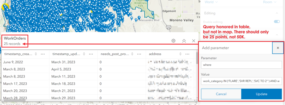

I'm having a similar issue, but with the geometry not being reflective of the parameter that was added. Only the table is actually performing the query, but the visualizations in the map have not changed to reflect the query results. In the image below, I have a parameter set on a service I pulled in, and it's a simple where clause, which is reflected in the 25 records shown in the table. However, there are WAY more than those 25 points on the map. It is a sea of blue.
Anyone else experiencing a similar issue, and have you found a resolution?
Thanks!
Lindsay
AdamRepsher_BentEar
Hi Lindsay,
Most of the work I have done using custom parameters did not involve needing the map visualization.
Quick thought Did you add the custom parameters when you added the service to the map, or did you enter them after, in the 'Properties' section?  I remember that being an issue.  When I tried to enter them through the Properties section, I did not see any filtering.  I just don't remember if I looked at the table too,  (Funny, since I wasn't needing the map visualization, only the data...)
--Adam

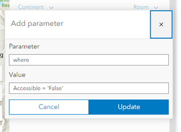

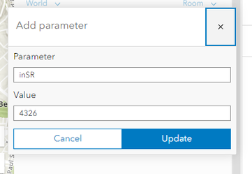

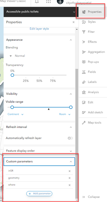

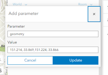

Thank you for this tip regarding the properties section! I have my spatial filter working now.
For anyone who gets a bit lost finding this, here's a screenshot for reference.
Add layer from service url (don't add any parameters) > go to properties > add custom parameters
Format parameters - e.g.
I've found that the minimum custom parameters to use are inSR and geometry. It seems that you don't need to include geometryType or spatialRel for the filter to work. outSR stops the filter from working.
The 'spatial inputs' section on the api explorer is handy for getting the geometry coordinates in the correct order - especially if you're working with data outside of the US/northern hemisphere https://hub.arcgis.com/datasets/b85233f0b21a4a9c9044ad21f459ed4a/api?layer=0
