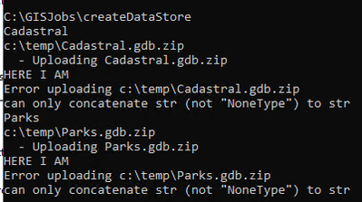

I have been attempting to export our Enterprise database data in smaller chucks out to File GDBs and then uploading them to the ArcGIS enterprise portal and publishing them, but when I attempt to script the overwrite, i get this error:
Perhaps there is a better way of doing this.  Thanks.
