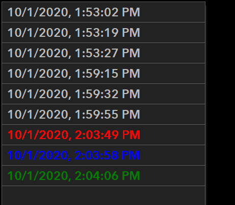

ChrisPetzold
I used a Survey123 domained feature class with coded values. The label for my responses was Red, Green and Blue for my 'Favorite Color' field and the values for each were coded as the hex values for the colors I wanted represented.  It turned out to look like this in my Dashboard list (I was just using edited date as my return just so I could have an output):
(Ignore the first 6 entries, those were test values...third time's a charm!)
<h3 style="color:{favorite_color}"><strong>{EditDate}</strong></h3>
Hope this helps.
