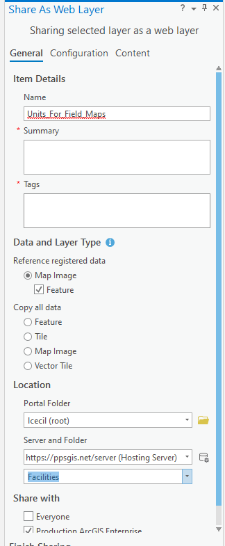

Yes, I was editing attributes on the sde data in Pro. There was a mistake in the Level_ID field needed for Field Maps. Should I bring the Portal Map into Pro and edit there? I'll need edits to go both ways though. The layer is sync enabled.
LeviCecil
I thought I did publish it as a referenced feature layer?

Based on your above screenshot, that looks like you are publishing the data as a referenced feature service. My only note of caution would be if the data source is not registered with ArcGIS Server. then you may see a warning at the time of publishing indicating that says the data will instead be copied to the server.

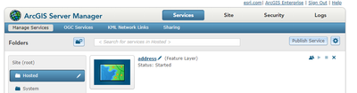

A good way to check if an existing service is hosted, copied, or referenced is to go to the Server Manager page. If the service is in the "Hosted" folder, it is a hosted service.

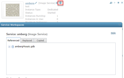

If the service is another folder it is not hosted. Further, you can click the database icon to see if the service is referenced or copied.
LeviCecil
It is a hosted layer in the server manager. The sde data source is also registered with the server. We had an identical set up on AGOL with a proxy hosted service from our sde and standalone server. When I made edits in Pro, they showed up in the feature service immediately, and vice versa.

It looks like the dataset was inadvertently published as a hosted feature service rather than a referenced feature service. I would recommend you run through the publishing workflow again, using the parameters specified in your above screenshot, and confirm that the service appears as "Referenced". If this is the case, then the edits should be dynamic as expected.

I republished exactly as in the screenshot, and now it's just a feature layer. Not hosted or referenced. Do I need to register the data as versioned in the sde?

What do you mean by "not hosted or referenced"? If you click the database icon next to the service in Server Manager, what tab is highlighted?
