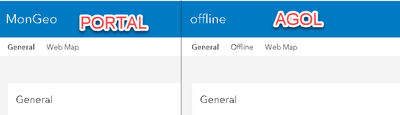

Hello,
I'm trying to prepare offline web map for collector using Portal for ArcGIS 10.7.1
All requirements for offline feature layer are completed. And I cannot see the offline option for web map.
But if I use ArcGIS Online and add prepared layer in the web map, I'm able to see offline option for web map.
What am I missing in the Portal for ArcGIS? or if there are any configuration during installation?
thank you.

hi @DerekLaw ,
I've just finished to check all requirements that you advised.
All looks fine.
I'm using one service for "AGOL" and "Portal for ArcGIS".
If the data/feature layer didn't meet requirement, then in AGOL shouldn't enable offline menu. right?
If there are any license requirement in Portal?
thanks.
