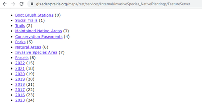

Many of my organization's web services are published kind of as "projects." For example, there's a service for monitoring invasive species that has multiple feature classes present (Invasive species, maintained native areas, boot brush stations, etc). These are all present in the authoring ArcPro document, so when you publish them to your server it looks like this:
So now you have multiple editable feature classes in one web service. It helps to bundle a bit of the service load. You can then add all of those layers to one web map, and/or split them up into different web maps depending on need.
