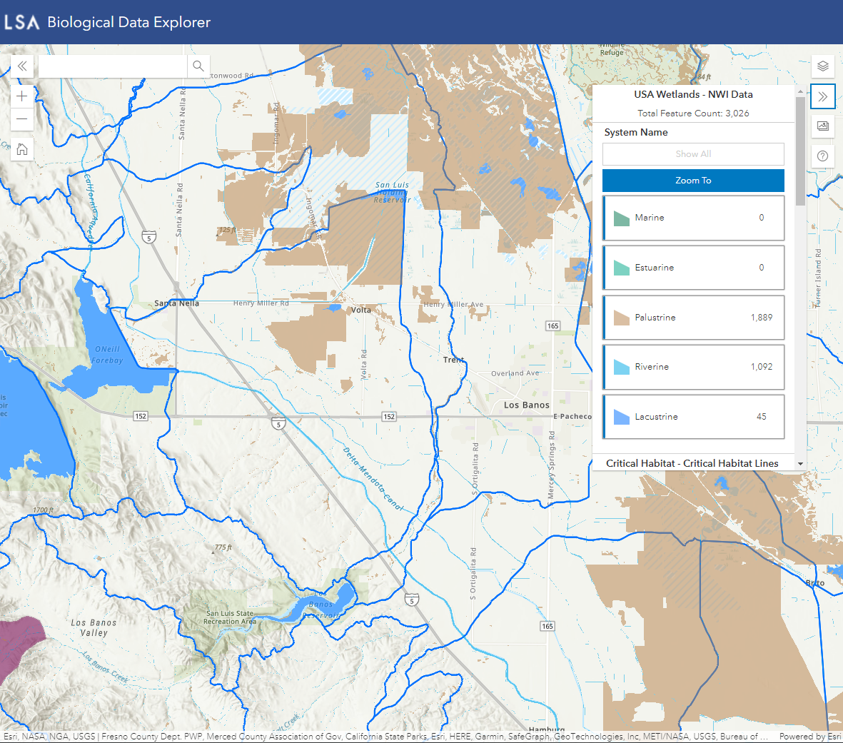

Here's the app launched from Portal, with basemap toggle in lower left:

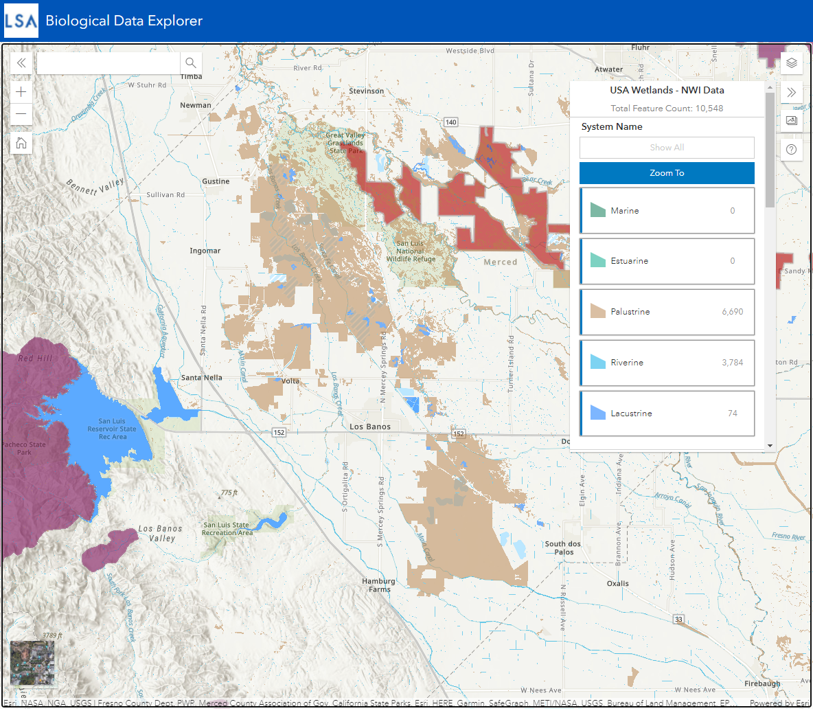

And here it is launched from AGO, with basemap toggle MIA:

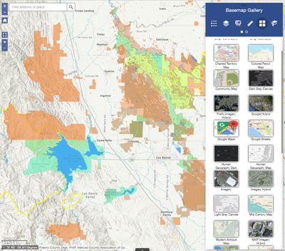

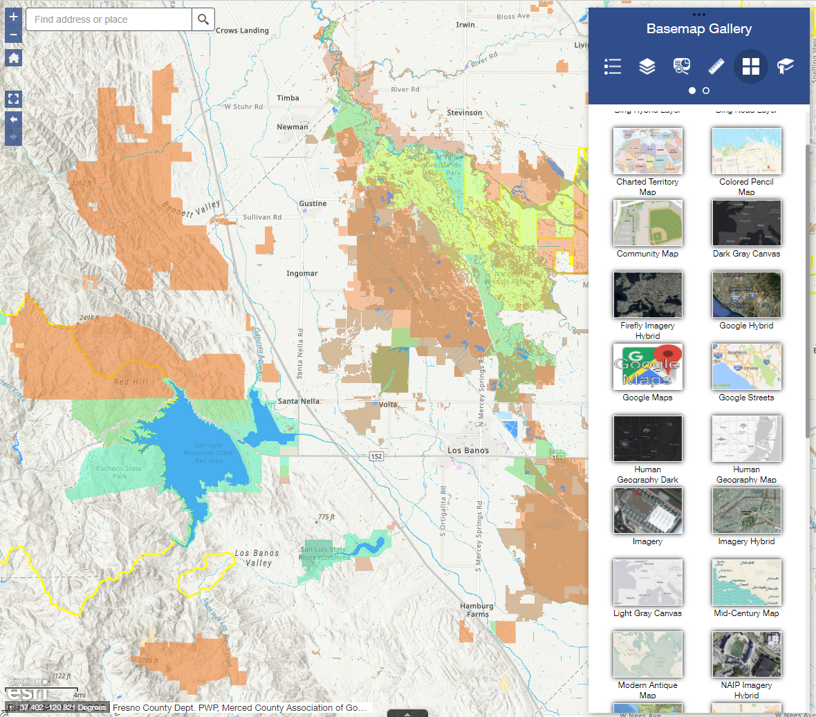

Here's the Portal-hosted WAB app launched from AGO with basemaps galore:
