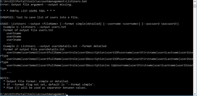

Hi everyone I'm looking for help running the ListUsers.bat supplied with ArcGIS Portal.
Having followed the instructions here everything is running fine and I'm getting a nice output as expected. However I have noticed that after entering my username and password and then run the script it seems to run over and over again. I've left the process running for XXX minutes and it is still cycling through and doing this.  It's very odd because I get this message even when creating a new file altogether. And the script does work instantly and creates the new file instantly as I'd expect.
Ideally I want to add this .bat to my Windows Scheduler and have it run once a month but I'm worried the .bat will just never stop running and continually be producing this error message and I don't want to block up the machine. When I run the script manually on the Server myself I just close the Command Window and be done with it, but if I create a scheduled task I wouldn't know how to add this and don't want it to run forever?
Any thoughts? Do I need to enter my command differently?
I'm no coder, so any answers in laymen's terms please!
Many thanks,
Steph
The error message is
Error: Output file already exists.  Provide new file name.
My updated code for listusers.bat
@echo off
..\..\framework\runtime\jre\bin\java.exe -classpath "lib\*;..\..\framework\lib\arcgis-common.jar;" com.esri.arcgis.portal.tools.ManageAccountsTool --listUsers %*
ListUsers --output "\\C:\Temp\PortalUserList.txt" --format detailed
