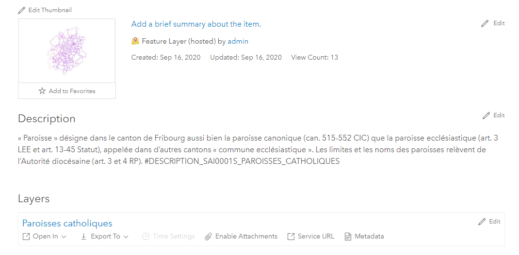

While I have been able to get the description to work in the portal (automated with Python) (see below)...

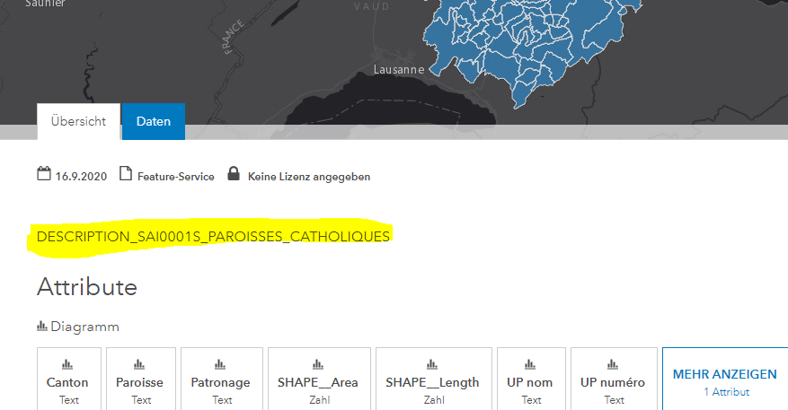

.... this is not the same what I get as description in  ArcGIS Enterprise Sites (see below):

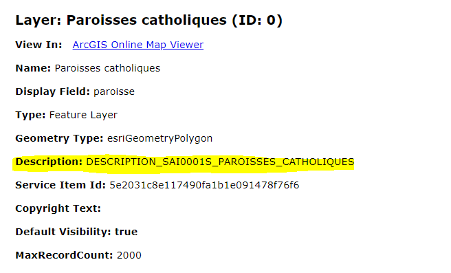

When I click on the Layer in Portal, I see the following:
Obviously Sites shows the description from the layer and not the one in Portal. Is this on purpose?
If yes, how is it possible to change the description?
I have tried that programmatically as below.
