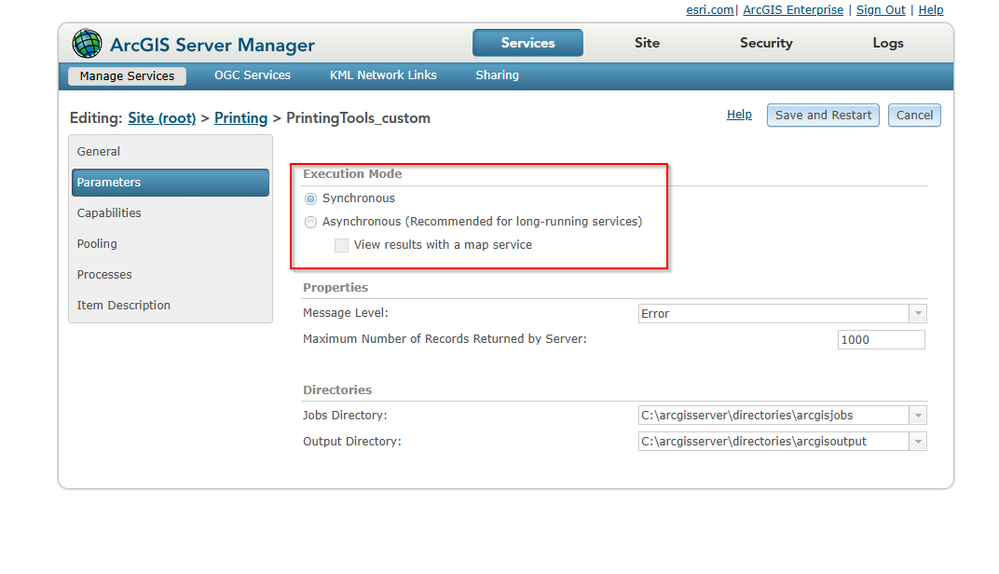

Another thing to check is the server manager for the service and try experimenting with the execution mode to see if either setting helps.

Have you ever tried putting the print service into Asynchronous Execution mode as mentioned above by Jon?

I'm going to give the built-in service a shot but unfortunately for this specific map (the framework of which is managed by a consultant), the mode must be asynchronous. That consultant ownership is another wrinkle of course, but I figure I oughta test as much as I can under my control.

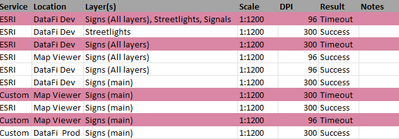

@TanuHoque and @JonM32 , the built-in print service does give me the same behavior. I've got a lot of variables here, so I'm going to keep a spreadsheet going on each of the tests. The third-party application is called DataFi, and we have a prod and dev skeleton that I'm using.
Looking at a set of initial 10 tests here, it appears at first glance the most consistent thing is the data itself. I've tested in Map Viewer as well, and the behavior is mostly reproducible there. Interestingly, we have situations where identical variables produce differing results. I think that might be a result of other users doing their own printing, so my request has to wait a bit to get an instance, then actually run the print. But that's a guess.
I'm going to keep up the testing and tweaking the inputs and I'll return with more updates unless someone sees something obvious that I'm missing.
