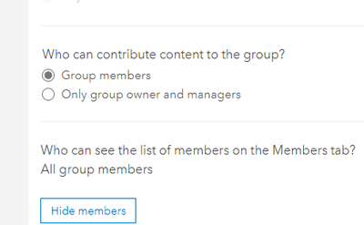

Check this option in each of your ArcGIS Enterprise Group settings (see screen shot).  We experienced the same issue as described above.  We think when a group is set up,  only group owners and managers can contribute by default.
