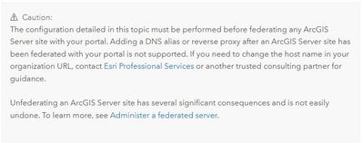

Question: Is it possible to change the name of the Portal & Server Webadaptors ???
Answer: From the technical support stance, it is unsupported, here's the doc that refer to:
