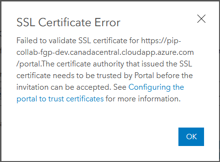

Now, when I attempt to accept the invitation in the guest environment, I still get the error that the certificate authority that issues the SSL certificate is not trusted.
What am I missing?
