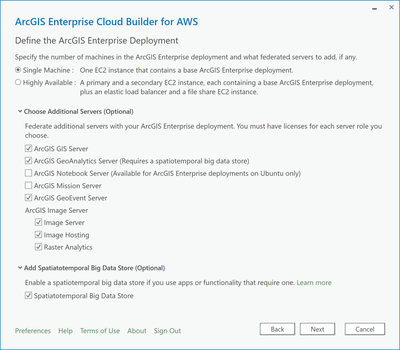

Goal is having Single Machine deployment on a base ArcGIS Enterprise deployment with additional server roles (AGS Server+GeoAnalytics Server-->BDS+Geoevent Server+ Image Server-->Server+Hosting Analytics) as pointed as below screen capture.
During the single-machine deployment using the ArcGIS Enterprise Cloud Builder for AWS app creating multiple machines like as Highly Available environment deployment. For roles, number of ArcGIS Server instances selected 1 for each roles.
However, deployment configuration as below: The expectation is that the total number of servers should be 14. However, after the deployment, the number of servers doubled to 28.
The behavior problem of the App is that it is like a multi-machine deployment, not a single-machine deployment.
