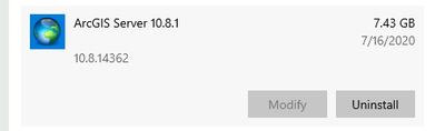

On the current 10.8.1 deployment (Windows), when I go to ArcGIS Server 10.8.1 the Modify option is disabled.  Will that not be the case after I upgrade?
ReeseFacendini
Esri Alum
Disabling Python 2.7 is an option only for deployments of Enterprise 10.9.1.  Any earlier versions, 10.9 or before, will not have that option present.  10.8.1 doesn't have any settings to be modified post installation, which is why that option is grayed out
