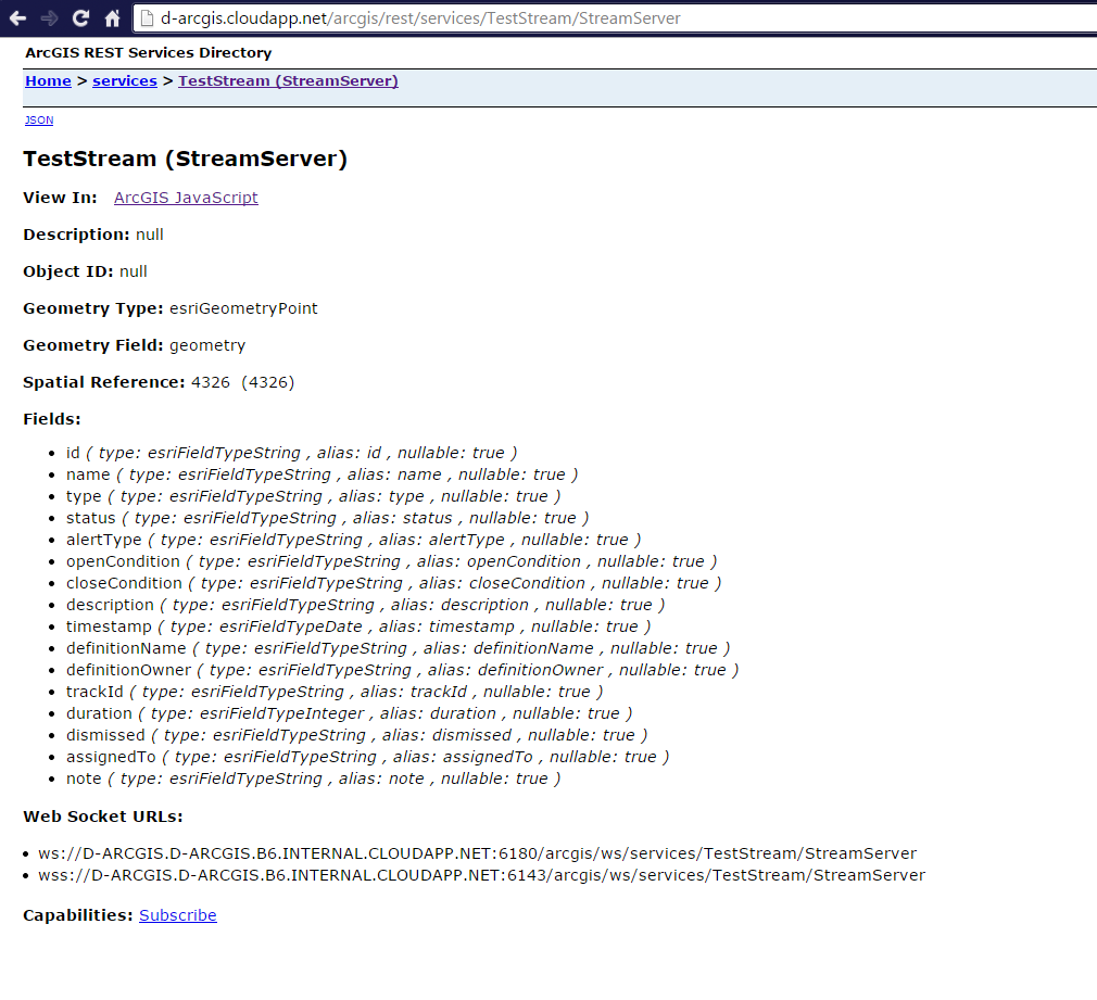

The issue stems from the fact that Azure uses local FQDN's within each Cloud Service network, which all have the format of  machinename.xx.internal.cloudapp.net.  The real external FQDN is machinename.cloudapp.net - however this is hidden from the perspective of the local machine and is taken care of at some higher level in the network architecture (I am not a network expert unfortunately).

Unfortunately the issue remains.  Below is a screenshow for the rest API call located at http://d-arcgis.cloudapp.net/arcgis/rest/services/TestStream/StreamServer (which is available over the net)  but the websocket addresses at the bottom are still using the local DNS naming.

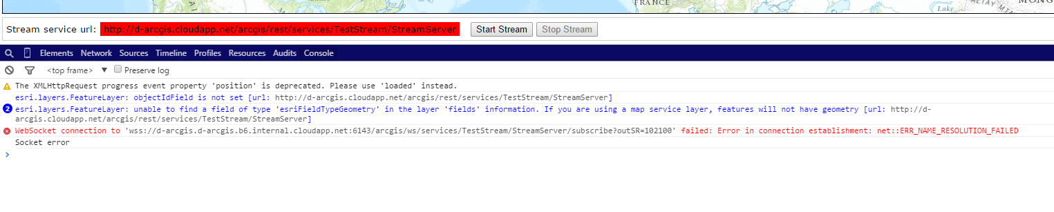

If you were to click on ArcGis Javascript and look at the Javascript Console in Chrome, you would see my suspicions confirmed:
