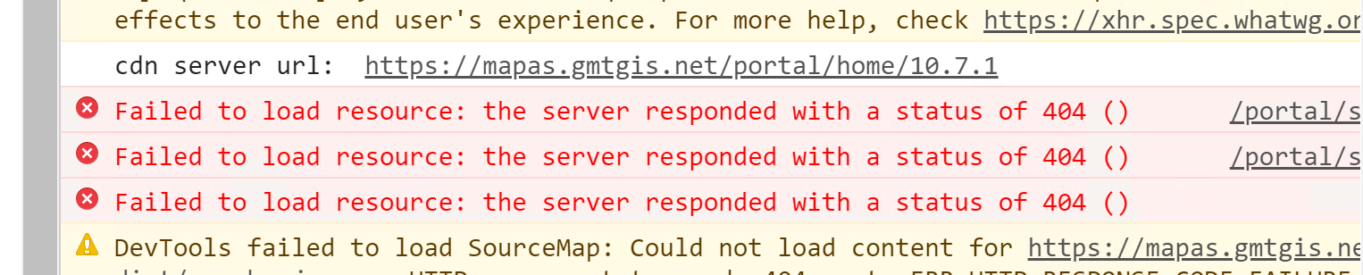

 Error I get from Portal, and home page stays blank

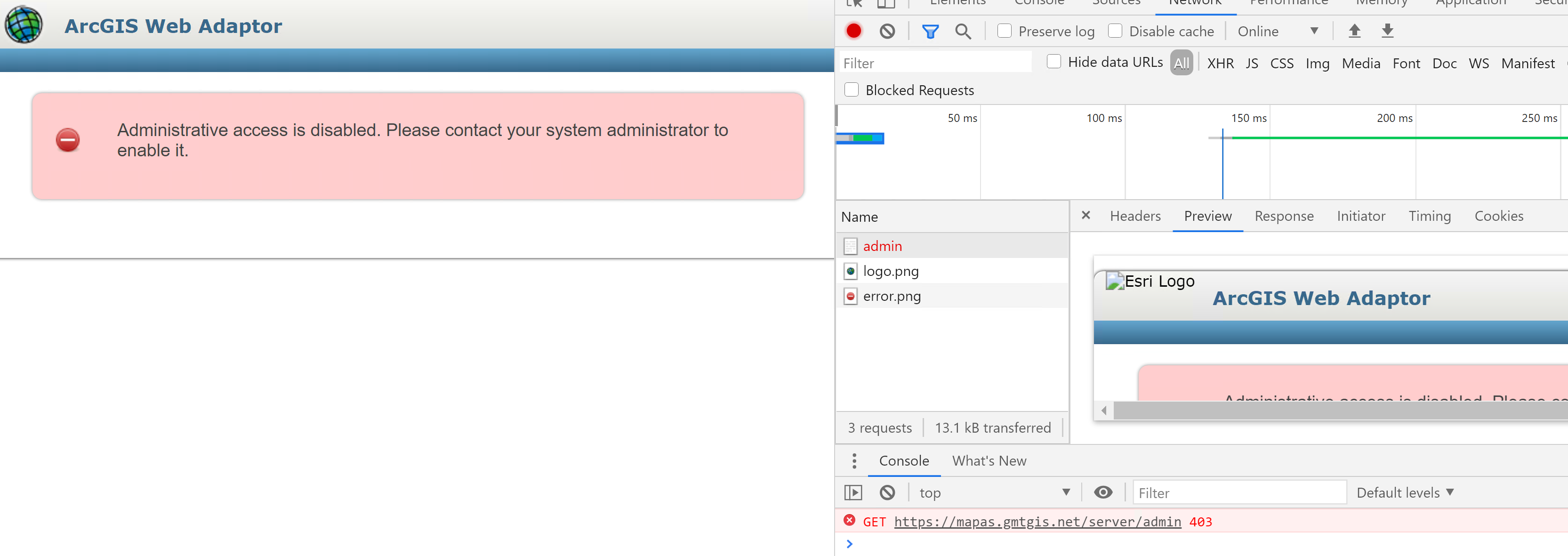

Error I get from server when I restart instance

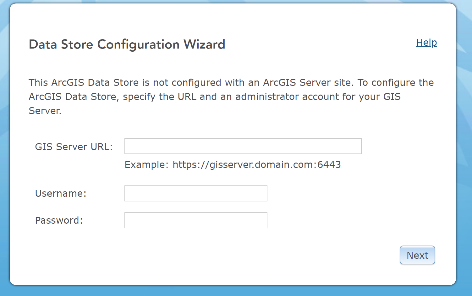

and Data Store seems like never was configured with Server.

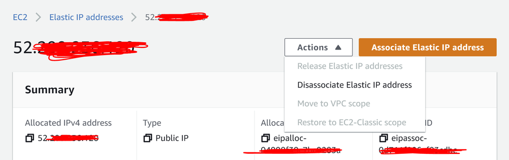

GeoffreyWest4
Are you using an Elastic IP?  My guess is that your hostname has changed when you stop and start your instance.
DiegoLlamasOlivares
Hello,
thank you for your response. I am not sure, i checked aws console and it says Elastic IP
How can I check this is not elastic any more and recreate my portal?
Thanks,
Diego
GeoffreyWest4
@Diego  - check your private IP in the EC2 console and the hostname file on your Portal machine- those should be the same.   How did you deploy this stack?
