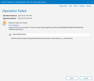

Same question as the OP. In my case, the folder indicated does not exist.
I also get an error when I try to generate the automation artifacts:
