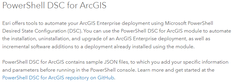

form our side for windows we usually use Home · Esri/arcgis-powershell-dsc Wiki · GitHub the PowerShell DSC they are fairly easy to use.

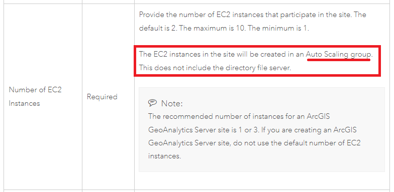

@formergeologist - AWS Cloud Formation Templates for ArcGIS Enterprise and PowerShell DSC are completely different tools to deploy ArcGIS Enterprise in AWS and Powershell DSC does not call AWS Cloud Formation Templates.
If you are interested to setup ArcGIS Server with the AWS EC2 instances auto-scaling group then look the AWS Cloud Formation Template below.
Other high availability templates
About PowerShell DSC
Automation solutions for your portal—Portal for ArcGIS | Documentation for ArcGIS Enterprise
About ArcGIS Enterprise Cloud Builder - another tool to deploy ArcGIS Enterprise
ArcGIS Enterprise Cloud Builder for Amazon Web Services—ArcGIS Enterprise in the cloud | Documentati...
NOTES:
  • AWS Cloud Formation Templates offer more advanced options to deploy ArcGIS Enterprise, especially related to high availability.
  • Hence, it might be just easier to use the Cloud Formation Templates, depending on the deployment that you are trying to do, than trying to deploy with Powershell DSC or Cloud Builder.
  • Each tool has its own learning curve, and each tool is unique, but the Cloud Formation Templates offer a lot more options and flexibility.
  • You need to pick the tool that is most convenient for you.
I hope this clarifies.
