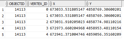

I want to write a SQL query that has rows with the XY coordinates of each vertex of an SDE.ST_GEOMETRY polygon feature class.
I can do it for a line FC using a cross join, a numbers table, and ST_PointN:
select
    a.objectid,
    b.number_ as vertex_id,
    a.sde.st_x(sde.st_pointn(a.shape, b.number_)) as x,
    a.sde.st_y(sde.st_pointn(a.shape, b.number_)) as y
from
    infrastr.active_transportation a
cross join
    infrastr.numbers b
where
    b.number_ <= sde.st_numpoints(a.shape)
    and a.objectid = 14113
But if I run that query on a polygon FC instead of a line FC, then I get an error:
ORA-20003: ST_Geometry type must be an ST_LINESTRING or ST_MULTIPOINT type.
ORA-06512: at "SDE.ST_GEOMETRY_OPERATORS", line 2614
If I comment out the lines that use ST_PointN, then the query runs successfully:
