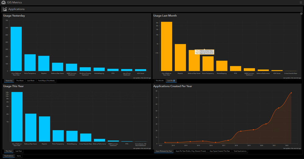

You could give this a whirl to see if it helps you out https://github.com/wagisdev/AGOL-Meta-Snagger.
It can snag data about all your items in AGOL, how many are owned by a user, the use of those services (can't tell by who, but it does give you a count), etc. I used it to build dashboards like this.
