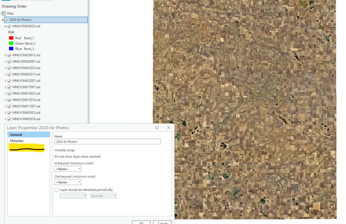

Please consider allowing map publishers a way to hide the layer names within a group. For example, our 2020 air photo service includes 13 individual MrSid files. I want the map service to only list "2020 Air Photos" and not "MrSid1, MrSid2, etc."
I realize that we could combine all the tiles into a single tiff layer, or I purchase image analyst extension. But either of those seem to be overkill.
Figure 1.  The layer group should include the option to "Hide Sublayer Names from the Table of Contents".

        The image you provided appears to be from ArcMap.  ArcMap and ArcGIS Pro are full featured Desktop GIS tools designed to give the user full access to datasets.  If your users don't expand the group the sublayers will remain 'hidden' but I doubt that is the functionality you want.

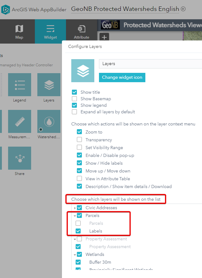

We use the Web AppBuilder (WAB) to publish many map viewers.  In the WAB it is possible to suppress the sub-layers in the legend widget.  Would a WAB app be a suitable replacement for what you are trying to accomplish?

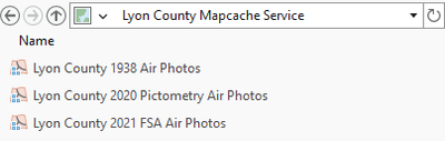

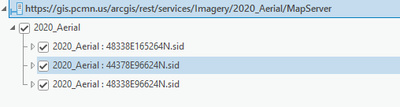

I should clarify that my ultimate goal is to use ArcGIS Server to make a Map Service that does not list any of the sublayers.  Here another screenshot from a neighboring county.  Obviously the air photo map service is important, but any end users dont need to know which MrSID files are included in the  2020_Aerial Map Service.
I could hide the individual MrSID layer names within the Web Application Builder and hope that desktop users don't expand the layer, but I prefer not even acknowledge the sublayers in the service within ArcGIS Server.
Figure 1:  The Map Service shows all of the MrSID names that are used in a map (Not Desired)
Figure 2: This 3rd party map service hides all of the MrSID file names that are used in a map (Desired)
