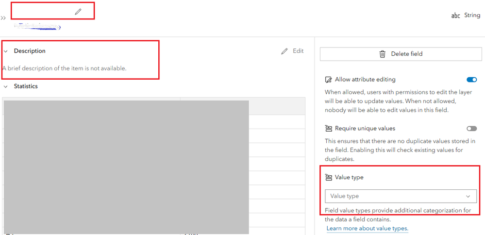

I'm using distributed collaborations to share copies of hosted feature layers from ArcGIS Enterprise to ArcGIS Online.
When I update the field alias (display name), field description and field value type of the portal item in ArcGIS Enterprise (using the data tab), only the field alias persists in the copied item in ArcGIS Online if I share it to the collaboration group.
I would like for all the configurations (field aliases, descriptions and value types) in the portal item in ArcGIS Enterprise, to persist in the copy in the receiving portal.
  • Is it possible to make this an optional enablement so that all the changes carry over, not just the field alias?
Table view in ArcGIS EnterpriseTable view in ArcGIS Enterprise

Below is the table view in ArcGIS Online
Table view in ArcGIS OnlineTable view in ArcGIS Online
