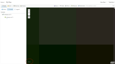

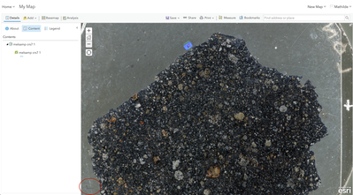

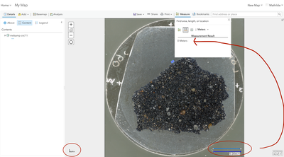

The ArcGIS Enterprise Map Tool can already interpret custom coordinate frames and zoom to data on the micrometer scale.  However, data at scales smaller than the centimeter level cannot be fully analyzed because the smallest unit that the Map Tool’s scale bar and measure tool display is meters and only down to 1e-2 meters.  Zooming to a level or measuring anything at a smaller scale result in NaN and values of 0.  By either extending the number of decimal places to 1e-6 meters or including units smaller than meters down to micrometers, the Map Tool can be used to analyze data it is already capable of displaying and becomes accessible to microscopic datasets.

The image above shows example microscopic data being displayed in the ArcGIS Enterprise Map Tool.  This layer was published as a dynamic map service layer with a custom coordinate system that was defined in ArcMap.  The scale bar in the lower-right corner is built into the dataset and should measure 5mm across.  The Map Tool displays this measurement as 0m.  In the lower-left corner you can see the Map Tool’s scale bar is collapsed and displaying “NaN”.  The images below, highlight that while the Map Tool is capable of zooming in on the micrometer scale, the scale bar is not functional on the micrometer scale.
