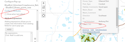

Amanda__Huber
@ThomasEdghill it appears this issue has been resolved (hooray!) I just tested one of our services and it appears that unchecking the "Show when last edited" respects enterprise layers.
Thanks so much!
