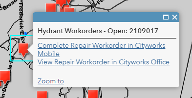

I would love if there were Arcade functionality to detect what platform a user was accessing a map from so that derived content could be displayed accordingly. My particular use case is creating links to access Cityworks items for field and office users. Field users would be looking at the map in Field Maps and use a URL to open it in the Cityworks Mobile app. Office users would view the map in Portal or a web app, and use a different URL to open in Cityworks Office.
Currently, I have to create two links in the same map (some potential for confusion) or maintain separate maps for field and office users (more work). Having a way to tell if the user is in Field Maps or a browser would allow me to tailor the experience to the user with less maintenance.
