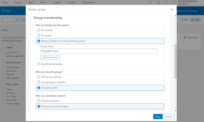

In ArcGIS Enterprise, you can create a group with membership set by an Active Directory group, with the content contribution option set to Group owner and managers, like this:

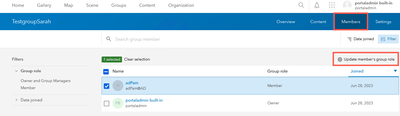

Then, update the role of any members who you would like to be able to contribute content to Group Manager by selecting their name in the member's list for the group and choosing Update member's group role:
Once their role has been updated to Group Manager:
They will be able to contribute content to the group. There is one important caveat though that I found while testing, which is that the Group Manager will needs to contribute content to the group using the 'Add items to group' button on the content tab within the group:
If they try to add it another way, such as browsing for content within the organization's main content tab, they will find that the group is not listed to share to. This is a known limitation.
