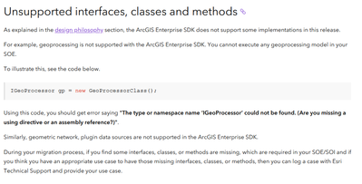

When I build SOE (or SOI) with old ArcMap ArcObjects I could use all the GP tool.
I used the Geoprocessor library and DataManagementTools (or others) for the tools.
GP tools is important part of any ArcObjects code.
These libraries does not exists in Enterprise SDK.
The tools does exists on the server, you can use them in gp services in Python.
How do I put them into my SOE code?

Where is the screen shot taken from? Can you send me a link?
In the last question of the Frequently asked question the question is can you work with utility network and geometric network and the answer is about utility network only 🙂
Thanks
nicogis
MVP Alum
Hi Mody
https://developers.arcgis.com/enterprise-sdk/guide/net/migration-strategies-net/
Yes geometric network, plugin data sources are not supported in the ArcGIS Enterprise SDK
