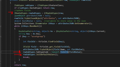

Hi, I'm adding a newFeature to a Utility Network using a SOE.
The problem is that when i add a new Feature it is all with null value.
Due to the fact that same fields are not editable,i can't modify them and they are still null so when i store the feature i receive an error of "null value not allowed". There is a way in the enterprise SDK to add a new row with the default values?
pspada_WT
For who has the same problem i had found the solution. This problem is raised in case of tables with subtypes.
So when you create a new feature you had to set the subtype with the relative code and initialize the default value
