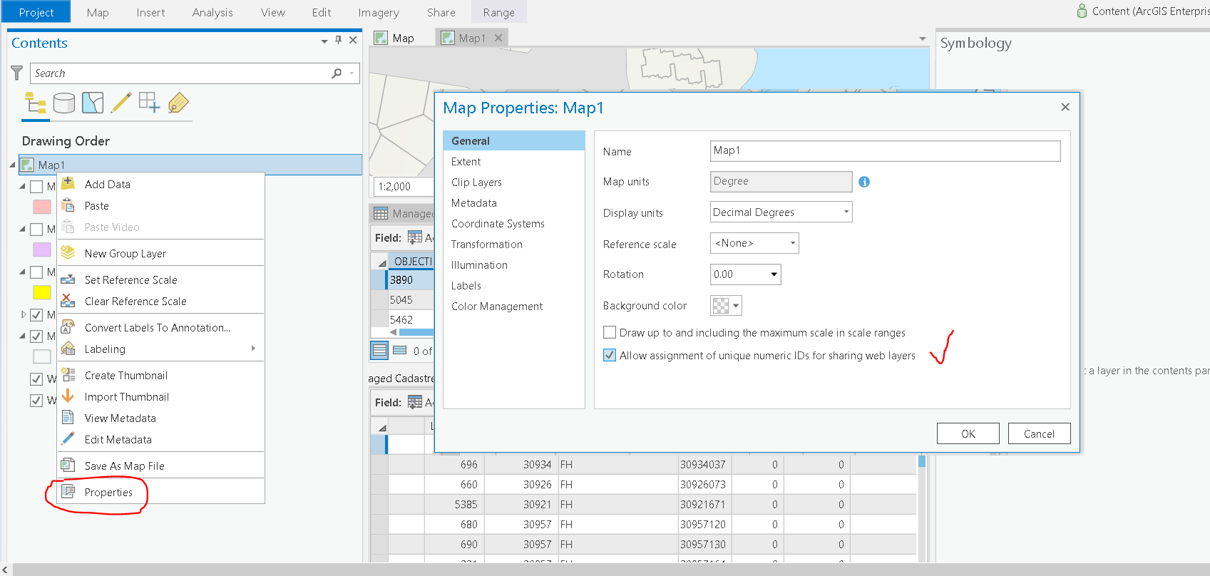

This can be enabled in ArcGIS Pro at the time of publishing by selecting on the contents pane → right click on the map icon → map properties → general → “Allow assignment of numeric IDs for sharing web layers”

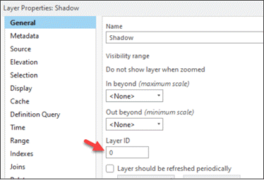

Once this has been activated, each layer will be assigned a unique ID (visible in the layer properties).
After this setting is configured, the layer order in the contents pane becomes irrelevant and the published service will order the layers based on their unique IDs. This is important to understand when setting up and visualizing your data for publishing.

  1. if you never used this option before and you want use this now to overwrite an existing service, then I'd highly recommend you to double check layer-ids that get assigned to each layer (after you check 'allow assignment...' checkbox) with the layer ids you will see in your service REST resources. And make sure they match. If they don't you can open each layer properties page and update Layer ID in its General tab. Otherwise you might run into some issues.

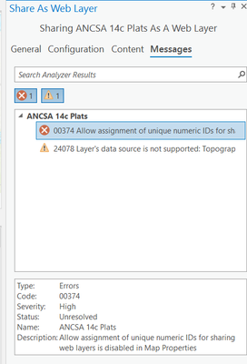

So allowing Unique IDs for multi-layer documents to tie down specific REST endpoints has been around in ArcMap since at least 10.2 or 10.3 (I'm not sure if it was supported in Pro initially but is right there in your face starting with 2.9.2). There are good reasons to want that functionality when managing Public REST Legacy services with many many endpoints that have other applications tied to specific items - but I'd consider that an advanced option and requires rethinking and being very careful managing Maps (either in ArcMap or Pro) that have Map Properties->Allow assignment of unique numeric IDs for sharing web layers turned on. It is not what I would consider good default behaviour to have on. However it looks like starting around Pro 2.9.2 it now looks to be trying to force users to turn on the map setting as pictured by initial post on this thread. I suggest this is not the right default behavior desired.Allow assignment of unique numeric IDs for sharing web layers setting Error 00374.PNGAllow assignment of unique numeric IDs for sharing web layers setting Error 00374.PNG
Suggestion is that Pro should be able to publish a map without forcing user to turn on Map Properties->Allow assignment of unique numeric IDs for sharing web layers.
