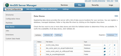

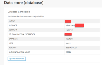

@vijaybadugu did you update the Data Store connections to the new SQL instance after the migration?
If the connections were registered via ArcGIS Server Manager, they will need to be updated there:
If the connections were registered via Pro, they will need to be updated in Portal:

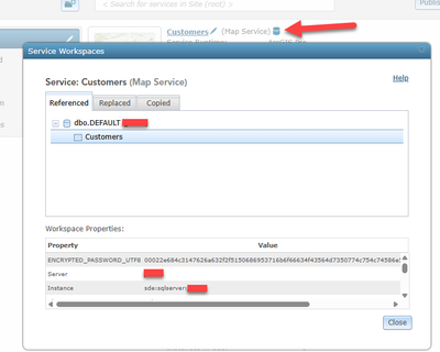

Once the Data Store connections are updated, the services should work without executing these scripts.  These scripts will only update the services metadata:

I could see all the data after updating data stores. So, Do not have to update any metadata then ?
JakeSkinner
Esri Esteemed Contributor
@vijaybadugu no that is not required, but a nice to have.  That's what these scripts will do.
vijaybadugu
I went to portal and update/import all datastores manually related to old instance with new sde. that's it. nothing I did for services. services still showing old instance and was able to see the data.
