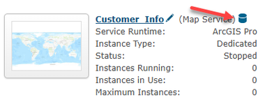

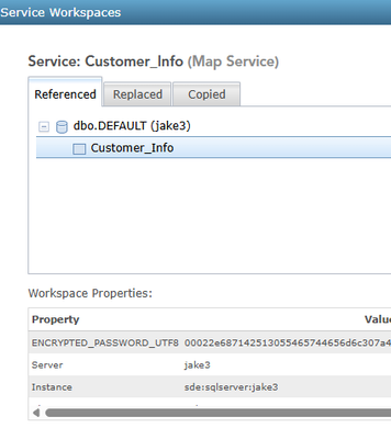

@ShelbyZelonisRoberson correct, that is not the case.  The easiest way to update your services is to update the existing Data Store connections, either in ArcGIS Server Manager, or in Portal, depending on how it was registered.
In either case, you would create a new SDE connection file to the new database instance and re-upload that.  Ex:
Portal
Once the database connection is updated, the services are pointing to the new SQL instance.  However, if you hover over the service workspace information, it will still state the previous instance:
You can run the script above on any machine that has ArcGIS Server or ArcGIS Pro installed to update this information.  If you update the existing data store connections, you don't have to worry about updating the previousDSID or newDSID variables, only the previousInstance and newInstance will matter in this case.
