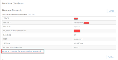

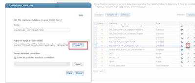

@ShelbyZelonisRoberson correct, that is not the case.  The easiest way to update your services is to update the existing Data Store connections, either in ArcGIS Server Manager, or in Portal, depending on how it was registered.
In either case, you would create a new SDE connection file to the new database instance and re-upload that.  Ex:
Portal
Once the database connection is updated, the services are pointing to the new SQL instance.  However, if you hover over the service workspace information, it will still state the previous instance:
You can run the script above on any machine that has ArcGIS Server or ArcGIS Pro installed to update this information.  If you update the existing data store connections, you don't have to worry about updating the previousDSID or newDSID variables, only the previousInstance and newInstance will matter in this case.

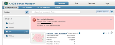

@JakeSkinner Yes we got the error in this screenshot. The support analyst I was working with said that this happens in 90% of cases that he sees and his conclusion was "existing services are likely to break if any of the following parameters are changed during migration: Database machine IP address, database instance, database name, username and password."
JakeSkinner
Esri Esteemed Contributor
@ShelbyZelonisRoberson that is strange.  What changed from the old data store connection to the new one?  i.e. username, password, instance name?
Are you connecting with Operating System Authentication?  If so, does the ArcGIS Server service account have read privileges to the feature class/?

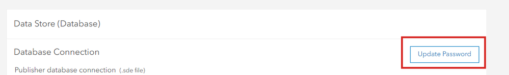

Can Portal DB connections be changed in general - the button is just called ("Update password")?
Since the changed connection information to the new DB we configured on ArcGIS Server Manager connection and Portal item DB connection switch back to the original one, once we restart the ArcGIS Server Service, we also have to think about using your script.
Our next try is to create new DB connections referencing to the new DB and changing the reference of the services. Unfortunately we can not find any "previousDSID" in the extracted msd, neither in the Portal item DB connections, nor in the ArcGIS Server Manager DB connections.
Do we miss anything?

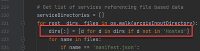

if __name__ == '__main__':
    # Get list of services referencing enterprise geodatabase data
    serviceDirectories = []
    for root, dirs, files in os.walk(arcgisInputDirectory):
        dirs[:] = [d for d in dirs if d not in 'Hosted']

                        print(root2)
                        for file in files:
                            os.remove(os.path.join(root2, file))
                        for dir in dirs:
                            shutil.rmtree(os.path.join(root2, dir))

After executing python script, Error handling service request :0x80004004 - Unable to instantiate class for xml schema type: CIMp in 'esriCarto.MapServer',
I just followed what you mentioned in it
