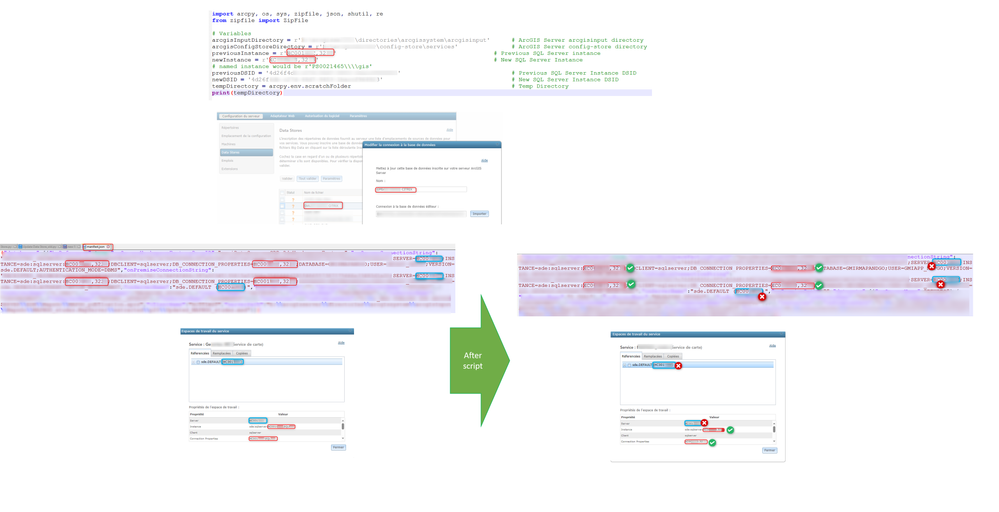

After moving your SQL Server instance to a new server, this guide will show you how to update your ArcGIS Server services. Additionally, it will demonstrate how to update file-based services that use data from a file geodatabase, such as map and image services, after the network share has changed.
Scenario
It might be necessary for you to move your SQL Server geodatabase to a different server. The 2022 instance, for instance, might be on a different server when you upgrade from SQL Server 2019 to SQL Server 2022. With a database backup and restore, moving the geodatabase is simple. However, what about updating your ArcGIS Server services? The services will use the SQL instance name if they are referencing information from your enterprise geodatabase. This can be fixed by re-mapping the data sources in your Pro Projects/MXDs, and then re-publishing your services.  But what if you have dozens, or hundreds, of services?  This can be extremely time consuming.  The below video will show how you can update all of your services with a couple of python scripts.
Note:
Before executing the scripts, be sure you have made a copy of the \arcgisserver\config-store\services and \arcgisserver\directories\arcgissystem\arcgisinput directories.

I asked Esri for help with this yesterday so this extremely good timing for me. This is far more detailed information.  I only regret I can't give more than 1 kudo.
JakeSkinner
Esri Esteemed Contributor
@Brian_Wilson let me know how the script works out for you.
Brian_Wilson
Honored Contributor
I ran through it in a debugger and tested.
Pretty interesting things going on down deep in the arcgisinput folder.
The re.search at line 127 and the re.sub would be a big problem for me since the current deployment is single machine and SQL Server runs in the same container. So replacing "cc-gis" with "cc-newserver" will also replace all strings referencing the other components, breaking everything.
Our new deployment will have "cc-gis" and other machines like "cc-gisserver" and "cc-gisdatastore".
I would need to use a more complete regular expression to avoid a problem. I have not found any manifest files directly referencing the database server so I cannot construct a proper regex. I think it might be using "sde.default" and mapping in the server elsewhere??? I do see references in the MSD files to the ID.
The Esri support guy told me I can change my SQL Server instance by creating an SDE connection doc that points at the new server and then import it on this screen. I will be trying that soon. What could possibly go wrong? I am thinking that if this updates the connection without changing the ID then none of the MSD files should need to change.
I would have made a terrible open heart surgeon. "Wait wait, we need to make a full back up first, and then we need to stop the patient while we do this! Let's get a snapshot and have a virtual copy of the patient ready in case this one fails." (I recall there is a John Varley story along these lines out there.)

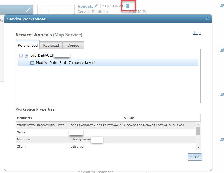

I noticed that there are more comments for certain layers than others, which seemed peculiar.  For example, for the majority of layers, it simply wrote:
Extracting Administrative_Boundary_Layers_050922 file to temp directory
Removing extracted content
Extracting Census_Tracts_2020 file to temp directory
Yet, for a handful of layers, it seemed to add more comments:
Extracting Subdivisions_061721 file to temp directory
Reading XML file and updating
Writing XML file
Creating new updated MSD file
Replacing original MSD file
Writing XML file
This also seemed to correspond to whether each service's Workspace Properties were updated within ArcGIS Server Manager.  Yet, even if the properties updated to the new server, they seemed to reflect this change in label only.  All services ceased to load, once we shut down the outgoing SQL Server DB service to confirm, save for one layer that I manually overwrote from ArcGIS Pro, sourcing the new DB, as a sort of control example.

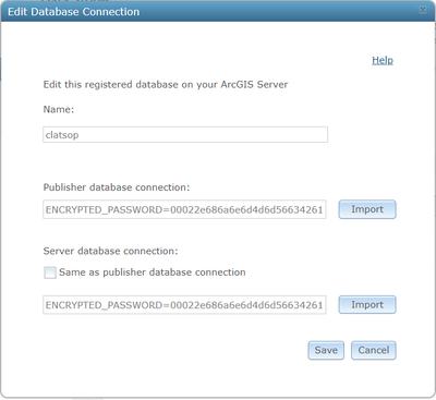

@GregCarlino2 you can update the existing Data Store connection to the new geodatabase connection file and the services will update, however the labels in Server Manager will not.
As for why the workflow is not working, I can't say for sure.  I would need to further trouble shoot.

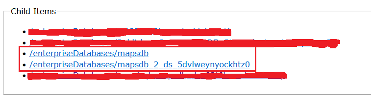

One potential cause of our failure might be concerning the correct DSID of the previous Data Store, as it seems I have two:  I'm assuming one is from before we upgraded from our old version of Enterprise (10.6.1), as it has no corresponding Data Store Item in Portal as layers were published from ArcMap; and one from afterward (post 10.7.1), which has a Data Store Item, evidently created once layers started to be published from ArcGIS Pro.  How do we know which one is the correct one to use with the script?  Does this imply that when layers are published, they are encoded with one DSID or the other?  If so, can I run the script once for each DSID, or will that have a deleterious effect?
Thank you,
JakeSkinner

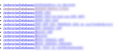

@GregCarlino2 the mapsdb_2_ds_5dvlweynyockhtz0 data store is when you register a data store in ArcGIS Pro.  It will create an item in Portal.  If you create the data store connection in ArcGIS Server Manager by going to Site > Data Stores, it will create the data store connection as mapsdb.
Yes, you can run the script once for each DSID, that should not have an deleterious effects.

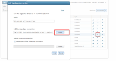

@AbiDhakal that only applies if you update the existing Database Data Store connection with a new SDE connection file that is pointing to the new SQL instance.
AbiDhakal
@JakeSkinner
I'm sorry I didn't understand that. So, if i were to have a completely new SQL Server instance with all the data inside new is when that applies?
Thank you. My apology for my ignorance.
Abi
JakeSkinner
@AbiDhakal try the steps outlined in this document first.  If for some reason it does not work, restore your snapshot.  You can then update the existing data store connection with a SDE connection file pointing to the new SQL instance:
Your services will redirect to this new SQL instance at this point.  However, updating the existing data store connection will not update the workspace information when you click on this option for the service.  Though, it is in fact pointing to the new SQL instance.

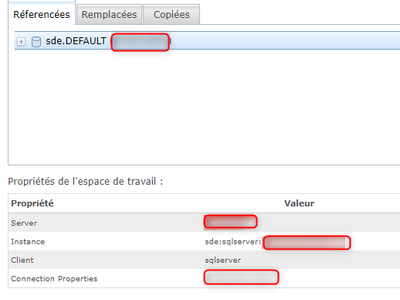

LouisDECOMBE
Hi @JakeSkinner
Thank you for your excellent work. It's been very helpful in understanding what needs to be done.
In my case, I have many databases registered in ArcGIS Server, and I don't really want to create a new one for the new instance. I plan to simply update them using the SDE file. However, from what I understand, while the map services will continue to function, the information displayed in each map service will reflect the old data. This isn't too bad, right?
That being said, is there a method or script available that allows me to update the information in each map service after updating the database (without creating a new one), ensuring that the IDs remain unchanged?
Thank you for your advice.

@LouisDECOMBE for the script variables, you can update the previousInstance and newInstance.  For the newDSID variable, simply specify this to the be the same as the previousDSID variable.
LouisDECOMBE
@JakeSkinner , Ah yes, I hadn’t even thought of that! Thank you. I will test it

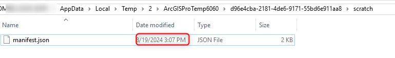

@JakeSkinner
I tried, but it seems there was no change in the manifest or MSD file, even though AGS was stopped.
I have the new manifest in the scratch folder, but the information inside is the same as before.
Any ideas?
JakeSkinner
@LouisDECOMBE I'm not sure which release, but it looks like the MSD files, when extracted, now contain a directory called layers instead of map.  I've updated the script to accommodate for this.  Try the latest script and let me know if this resolves the issue.
LouisDECOMBE
@JakeSkinner ,
Thank you. I think I see where my problem is.
In the image below, the red boxes indicate what the script manages to update. The instance name is different from the SQL server name (blue box). Thus, the script only updates the parts outlined in red. Maybe I need to adapt it to also update the parts in blue. If you have any ideas, I’m all ears.
Additionally, the files in the config-store directory are properly updated. However, in the arcgisinput folder, only the p20/name_service.msd files are updated, not the manifest files. Could this be an issue?
In any case, thank you for your prompt response each time.
