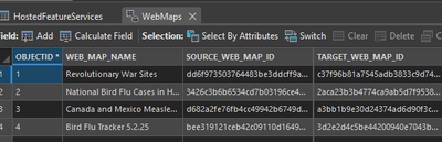

Each script for content (i.e. services, web maps, apps, etc) creates an output table in a File Geodatabase that contains the source info and target info.  This information is used by additional scripts.  For example, the Migrate Hosted Feature Services script creates an output table like below:
Then, when the Migrate Web Maps is executed, it reads this table to do a find/replace of the services in the web map.  The Migrate Web Maps script also creates another table in a File Geodatabase to be used by the scripts for the app migrations:
