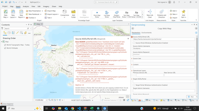

I am getting the error shown in the attachment. The portal version is 10.6.1. Could the error be due to the version because I do not encounter any problems when I try it via the 10.9.1 portal url.
JakeSkinner
Esri Esteemed Contributor
Hi @SedaKahraman remove the /home/ from your Portal URL.

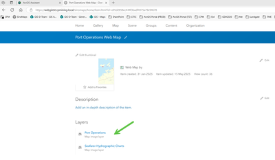

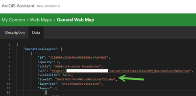

Just noticed that when copying web maps the itemId for the map service does not get updated to new itemId in the destination portal.
The map still draws as it uses the URL of the service, but when going to the Map Item in Portal and clicking on the layer from the item details in Portal it comes up with "item not found", as the itemId is still the source itemId and not the destination itemId.
Is it possible to update the itemIds ?
Thanks
JakeSkinner

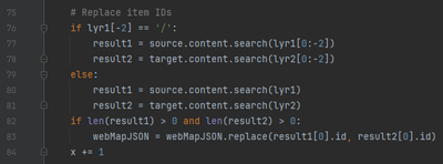

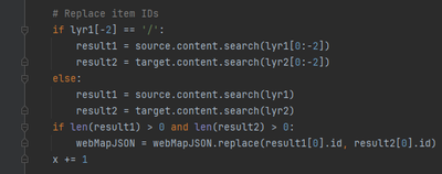

@stevetaylor_perth this functionality exists in the script:
The script will search each portal using the URL of the service to get the Item Ids.  It will then perform a find/replace within the web map's JSON.  I would search each portal using the URLs to make sure items are being returned.
stevetaylor_perth
Hi Jake - thanks for getting back to me
I am investigating the issue - seems like the target portal cannot find the itemId by url

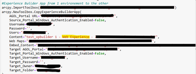

I was using it for Experience Builder Web App migration from one enterprise portal to another portal. Tool run successfully, item is created in target portal but its not working (failed to load).
Can someone confirm if tool works for experience builder app migration from AGOL to another AGOL organization?
Thanks
JakeSkinner
Hi @GeoAKS, yes this works migrating an Exp Builder App from AGOL to AGOL.  Is this reproducible with all Exp Builder Apps?  I've noticed sometimes if you don't tab out of the Web Maps and  Other Content parameters, the tool will not pick up the pasted value:

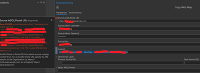

I am using ArcGIS Pro 3.6.0 and I am trying to connect to our ArcGIS Online environment, but I am receiving Error 032659. I can see that others have encountered this error in previous posts.
I am trying to move web maps from AGOL to Portal 3.11, but I keep getting this error.
However, I was able to successfully move dashboards and hosted layers from the QA Portal to the Production Portal environment.
Is it even possible to move items from AGOL to Portal? If so, how can I fix this error?
JakeSkinner
@anonymous55 you can move web maps and hosted feature services from AGOL to Portal, but not applications (i.e. Experience Builder Apps, Story Maps, Dashboards).  Can you post a screen shot of how you have the tool configured?
anonymous55
Hello @JakeSkinner
below is the screen shot of error also in arcpro I log in to arcgis online too.
JakeSkinner
@anonymous55 you will need to connect to AGOL with a built-in account.  Are you attempting to use a SAML account?

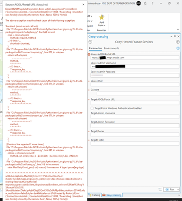

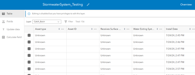

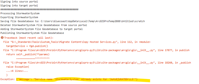

I am attempting to copy hosted feature services between two organizational AGOL accounts.  The connection between them and data transfer work, however I am receiving an error when it attempts to recreate the hosted feature layer on the target account.  It seems like the file GDB being created during the process is named the same as the hosted feature layer and throwing an excpetion.
I can see the GDB in the target folder, but unable to produce the copied feature layer.
JakeSkinner
@ebpip does the feature service StorwaterSystem exist in your Organization, possibly owned by another user?  Can you test another feature service to see if you get the same error?
ebpip
@JakeSkinner Thanks for the quick reply.  I did check and found a previously deleted version of the hosted layer on the target account in the recycle bin.  I permanently deleted it and the script was able to complete succesfully.  However, the new copy of the hosted layer on the target account is nearly empty.  It only resulted in two tables whereas the original has a dozen or so tables and about the same for layers, which I'm not seeing any of.  Any thoughts on resolution?  I tried with another hosted layer that is similar in makeup and it resulted in nothing being published to the new hosted layer, it is empty.
JakeSkinner
@ebpip can you share the service to an AGOL group and invite my account (jskinner_rats)?  I can take a look.
ebpip
@JakeSkinner I've shared stormwater with you, thanks a bunch for having a look.
JakeSkinner
Hi @ebpip, I was unable to reproduce this.  I downloaded the data and re-published to my Org as a service.  I then used the Copy Hosted Feature Service tool to copy to another org and it worked successfully:
I did this with ArcGIS Pro 3.6.
ebpip
@JakeSkinner Well ok then, thanks for testing it.  I will dig in a bit more and do some more testing on my end.  It may be something on the target org's AGOL.  I really appreciate you taking time to look into it.

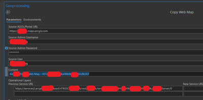

  1. I've migrated a map with a feature service and a map service - both service URLs are updated, but the item ID for the feature service points to the item in the first portal - am I missing a step? The map still works, and we can update the ID in AGO Assistant, but it would be nice to cut AGO Assistant out of the process.
  2. Also, it would be useful in future to be able to re-path base maps as well, as we use internal custom base maps, and need to re-path these.
JakeSkinner
@HelenWhiteley_tfl I could not reproduce the item ID issue.  This is incorporated into the code:
Is the Feature/Service Map Service added as an item in the target portal?  Are you using Enterprise?  If so, which version?

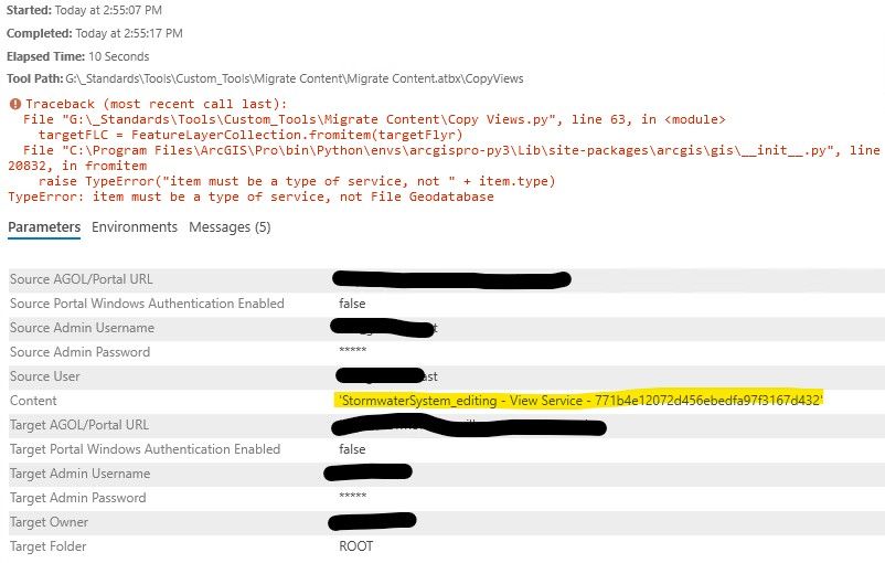

@JakeSkinner I'm trying to use Copy Views to move views between two organizations.  It gives it a go and then I receive the error message below.  Any thoughts on a resolution?  Thanks for the tools and the help.
JakeSkinner
@ebpip the tool will search the target portal for the parent feature service the view is to be created off of.  It looks like it's finding a File Geodatabase instead of the feature service.  First, verify you have the parent feature service in the target org.  Then, check if you have a File Geodatabase with the same name of the feature service.  If you do, delete it and try executing the tool again.  I may have to update the code to return only feature services during the search process.
JakeSkinner
@ebpip I updated the Copy Views tool.  Can you re-download these tools and try again?
