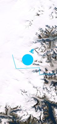

YujingChang
Hi @GeminiWolf
ArcGIS Earth mobile supports the display of points, lines, and polygons in KMZ/KML files. This means you can utilize this app to view the wetland polygons on your mobile devices. Additionally, ArcGIS Earth provides the capability to draw points, which could be beneficial for taking notes in the field.
To make the KML/KMZ files accessible on mobile phones, you can either load the KMZ/KML files from ArcGIS Online or Enterprise or import them locally. This ensures that you have the necessary data available for fieldwork and can verify the accuracy of your predictions in real time.
