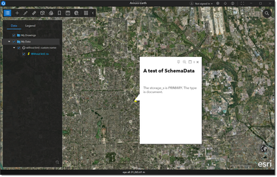

As a workaround, you could remove the custom namespace to make the data loaded in ArcGIS Earth. I have tried to remove those custom namespaces based on your snippets and KML can be loaded well into ArcGIS Earth.
<Schema xmlns:xsi="http://www.w3.org/2001/XMLSchema-instance" xsi:type="kmlSchema" name="user_name" id="data_schema">
  <SimpleField type="string" name="storage_s">
    <displayName>storage_s</displayName>
  </SimpleField>
  <SimpleField type="string" name="type">
    <displayName>type</displayName>
  </SimpleField>
</Schema>
<ExtendedData>
  <SchemaData xmlns:xsi="http://www.w3.org/2001/XMLSchema-instance" xsi:type="kmlSchemaData" schemaUrl="#data_schema">
    <SimpleData name="storage_s">PRIMARY</SimpleData>
    <SimpleData name="type">document</SimpleData>
  </SchemaData>
</ExtendedData>
Thanks,
Xuewen
