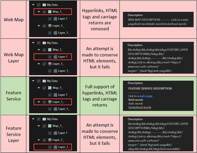

The summary tab for layer properties has been enhanced with 1.16. The documentation says :
“image, table and hyperlinks, as well as various HTML formats including paragraph, list, font size, bold, and so on are now honored in the layer description for a portal item or service layer properties”.
I found out that this is only true for Feature Services. It would be great if it could also be the case for Web Maps, Web Map Layers and Feature Service Layers :
Thank you.

Hi @GeoffroyRicher-Lalonde ,
Thanks for your feedback and the detailed comparison. HTML format description should be supported for every data type. We will dig into this issue and fix it. Thanks again for your feedback.
Thanks,
Xuewen

Hello @GeoffroyRicher-Lalonde ,
We have fixed this issue in the latest release of Earth V1.17. Kudos on your detailed feedback and description that it helped us to locate and solve the issue a lot.
Thank you and happy New Year!
Bing'An
