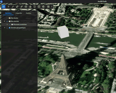

@Jay_Gregory If you have a 3D model, you can place it wherever you want.
There are a lot of free tools online that let you create 3D models. But yeah, it would be nice to be able to create a 3D model from an extruded polygon in ArcGIS Earth.

@Jay_Gregory, the polygon's "Extruded to ground" is aligned with this KML specification.   However, the extruded polygon is not a strict volume, so I am afraid other issues might arise when you use it as a volume. Thanks for the 3D model suggestion from @GeoffroyRicher-Lalonde , you might try this option.  In ArcGISEarth 2.4, we have updated the support for editing the 3D model in KML, it can be easily to duplicate and edit  them, you may have a try. We are very willing to your more feedbacks and details about you requirements. Thank you.
