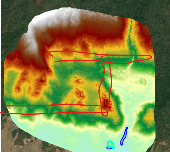

PatrickOswald1
I got a similar issue with tiling, there the resulting DTM has "steps" very different elevation values between the tiles resulting in steps that make the DTM unusable. My project is a rather big one with 10000 images and 3.5cm ground resolution. though it still should work as the DSM model looks good.
The same problem happened also with another larger project i had (15000 images). What to do?
