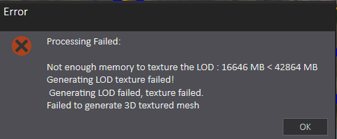

The project I was working on has 300 images and when I tried to create a slpk with HIGH texture quality and 5 levels of details, I received the below error message (Not enough memory to texture the LOD: 16646 MB < 42 864 MB).
I then changed the settings to a HIGH texture quality with 4 levels of detail, and I received a similar error message (Not enough memory to texture the LOD: 14952 MB < 19 568 MB).
It finally ran successfully when I used the MEDIUM texture quality option and 4 levels of detail.
As I have 32GB of RAM, why the error message? Or do I need to upgrade my graphics card in order to process this imagery? I would appreciate a brief explanation as to why I received this error message and what can be done to avoid it in the future?
