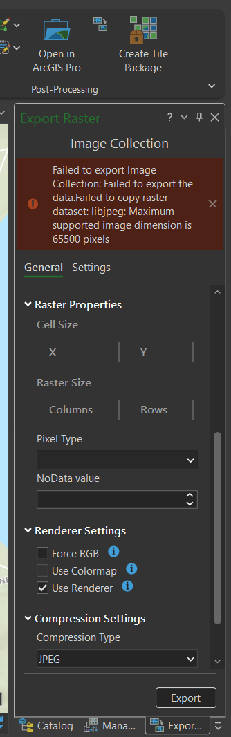

Project has 251 images over lake surface + shoreline.
I am attempting to export a basic orthomosaic through the image collection export. Originally, I tried to export as a TIF but that failed, so I changed the output format to JPG and lowered the compression quality to see if that would work. Each time I received the following error:
"Failure to export Image Collection: Failed to export the data. Failed to copy raster dataset: libjpeg: Maximum supported image dimension is 65500 pixels"

Hi @TaraBeckman,
Would you mind sharing the exact settings you were using within the Export Raster pane before the error occurs? Feel free to include a screenshot.
I have a few other questions for you as well:
  • Are the TIFF and JPEG formats the only ones not allowing a proper export? (i.e. have you tried PNG, GIF, etc.)
  • Is this occurring on other projects as well?
  • Is there a reason you haven't applied the patch yet for 2025.2.1?
