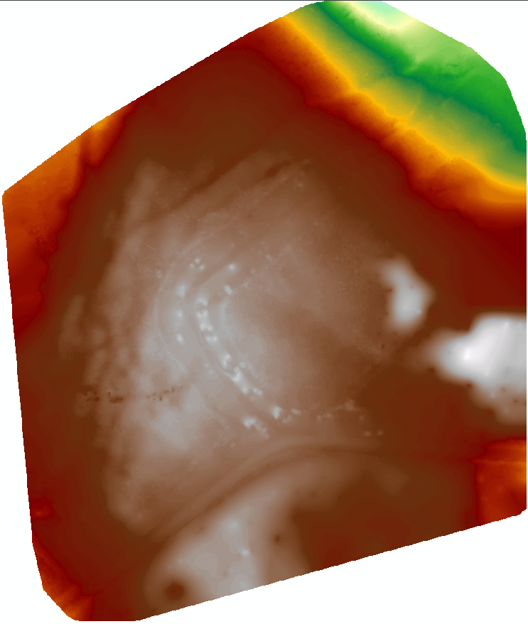

Where is the option to enable correction for rolling shutter in Drone2Map 2.0.1?
There is mention of an "Image Properties Window" in some online documentation (Image properties—Drone2Map for ArcGIS Help | ArcGIS ) but that seems to be for 1.3x and there is no actual documentation on how to access that window.
Any help or guidance would be greatly appreciated.

In Drone2Map 2.0, the software will automatically apply the rolling shutter correction if the camera is known to have a this type of shutter.

I am using a DJI Mavic 2 Pro and it does not seem to have any rolling shutter correction as the bowl effect is very visible (even more so with the point cloud):

I'm finding the same exact issue also with the Mavic 2 Pro, what is your image overlap set at?
