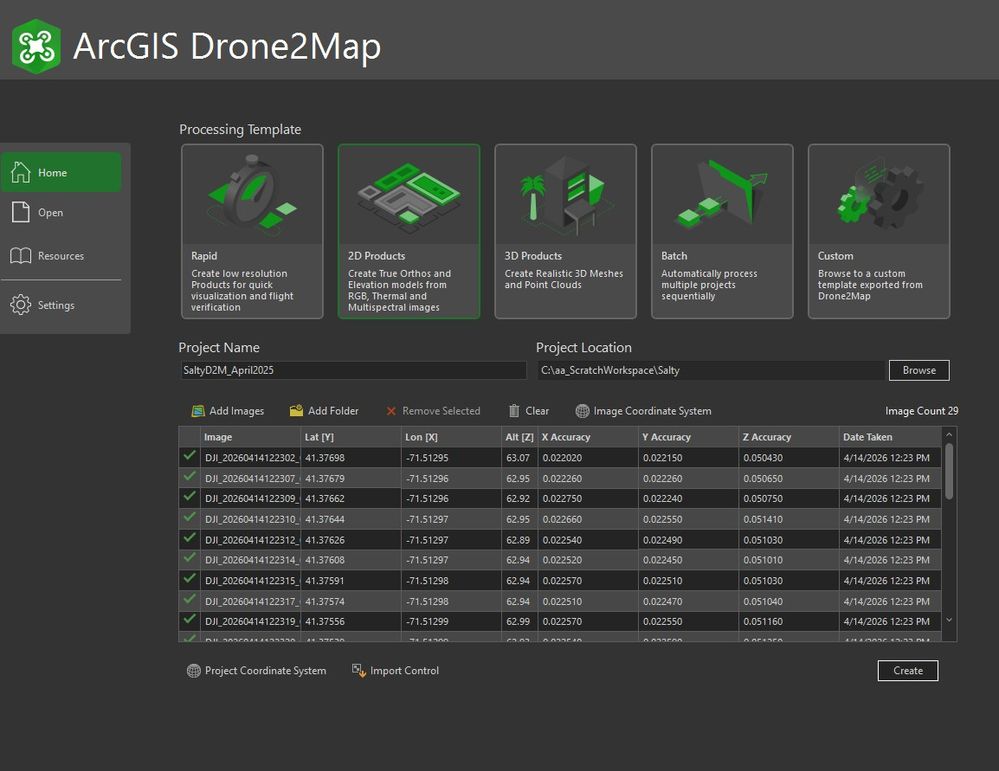

Drone2Map 2025.2.1 will not create project after specifying project name and location, and loading photos (only 65).  I press the create button and nothing happens.

Based off the error (ProjectService::UnpackProjectPackage Failed) and the fact its working with admin permissions I believe you are having an access conflict with either that path or another one that Drone2Map uses.
Do you have full access to another drive on the same machine? If so, you can try to create a project there and see if works. If it does, then the issue is most likely permissions based on the C drive. By default, Drone2Map creates the projects within the documents folder to try and avoid those conflicts (C:\Users\<username>\Documents\ArcGIS\Drone2Map). You could also try creating it to that path.
