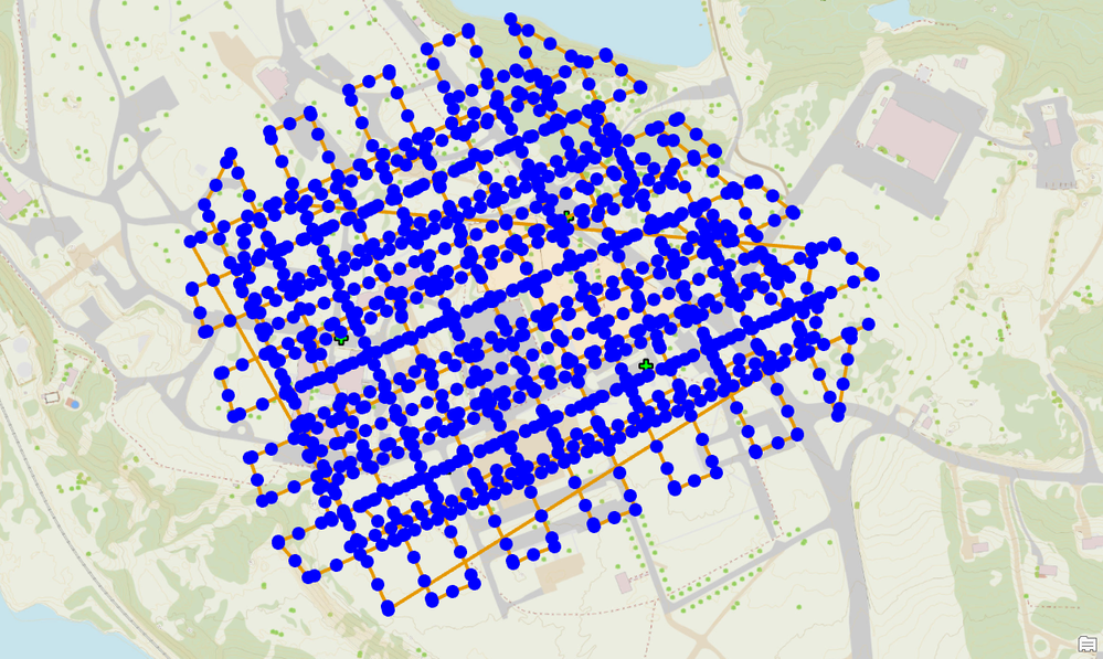

Thank you for the reply.  I will try re-processing with the point density to set to "High" and I will also try increasing the image scale to "1 (Original Size)".
There are approximately 1200 images for this project area.  The surface is fairly flat with some mixed vegetation.  here is a screen shot:

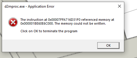

I tried running the project again last night (before making the adjustments above) and received the following error:
Is there any other information that might be helpful to diagnose this problem?
