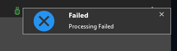

Hi all,
I am currently testing out Drone2Map to determine whether a full licence will be useful. I have installed it yesterday, downloading the most recent version.
However, when I follow this guide:
https://learn.arcgis.com/en/projects/get-started-with-drone2map-for-arcgis/

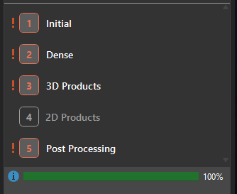

At the step where I press "start", the processing fails immediately, giving no information on the cause.
The timestamped log files are entirely empty, and the "ProjectLog.log" states only the following:
[Project][1][Info] Start Processing For Project Building Development Project
[Misc][0][Error] Processing Failed
The OS used is Windows 10 Enterprise, and the .NET Framework 4.8 has been installed.
If you need more information, let me know.
Thanks in advance!
- DroneTester

Try changing the logging level to Debug and run the processing again.  You can change the logging level in Drone2Map's general settings.
DroneTester
There was a windows update and the bug was fixed afterwards, without any further action from my side. Sorry for not being able to provide further info, the issue is gone now.
